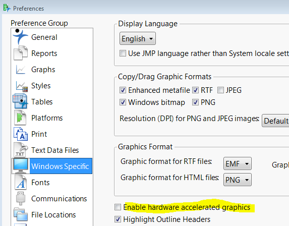

Craige_Hales
Re: Display of drop-down menus on an external monitor
Try turning off JMP's preference for hardware acceleration.
JMP on Windows has a hardware acceleration preferenceJMP on Windows has a hardware acceleration preference
Craige

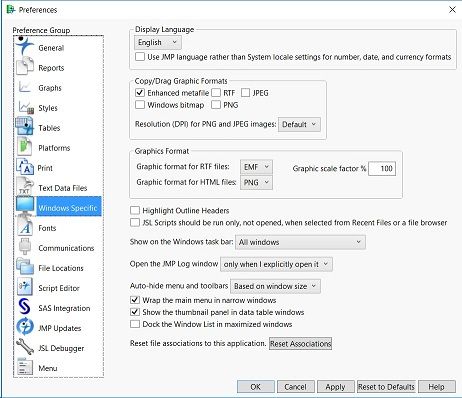

kardopaska
Level II
um what? i'm on Win10 both JNK 11 and 12 don't have the option you have?um what? i'm on Win10 both JNK 11 and 12 don't have the option you have?
I'm having MAJOR scroll lag when click draggin the scroll bar to the top or bottom of a 1000-line data table... I didn' thave this problem on Win 7?
