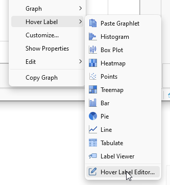

hi @SamKing , the template in Hover Label editor covers exactly this application case:
For your case it's':
Picture Box( Open( local:_link, jpg ) )
Don't forget the underscore!

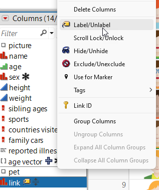

For the column link, to make it accessible via the local Namespace of the Hover labels framework just activate the "label" option

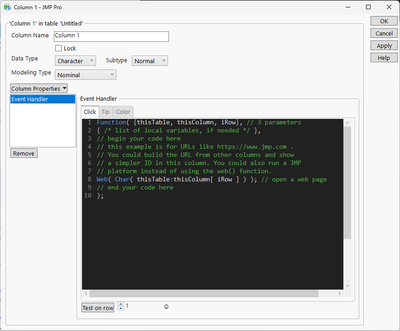

To table you can do it event handler column property
And in a graph Hover Label is a good option BUT they can trigger quite a few times, and it might be a good idea download the image to the table when user hovers over a point to prevent re-downloading every time.

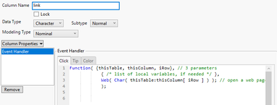

SamKing
Level III
Re: Display image on hover (but not downloading image to table)
Hi, I do have that already setup on my :link column but I use that just to create the hyperlink that shows up as a label. So I can click on that to take me to a browser to see the image.  But it doesn't show me a preview of the image, only the link.
