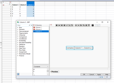

Hello,
I am struggling to implement a simple "contains" formula. Here's a sample data set and formula:
Here's the text: Contains(:Column 1, :Column 2)
The issue: I think it is always checking the current row of Column 1 (whole). I want it to check the entire column, not just the current row. You can see the E and B are in Column 2, but the output is saying that it does not find the part in the whole.
How do I explicitly say, check the entire column and not just the current row of the column?
Thank you very much!

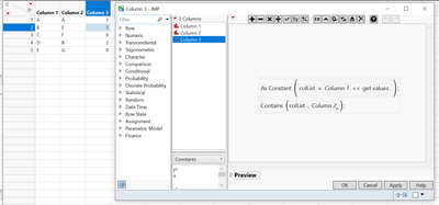

As Constant( colList = :Column 1 << get values );
Contains( colList, :Column 2 ) > 0;
Contains( colList, :Column 2 );

I tried this. It's much closer, but not quite what I'm looking for. It's counting something more than what I'm looking for. It says the B is 5 and E is 2. I just need true or false, 1 or 0.

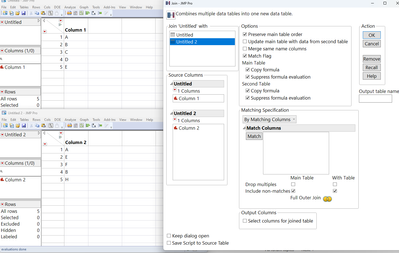

i would think the most obvious way of comparing columns (rather than rows) in JMP would be using table join.
perhaps something like this

it can also be done using clicking rather than scripting. as in the picture below
