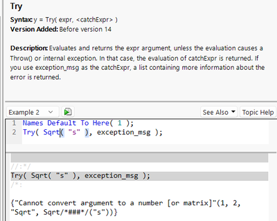

hogi
Level XIII
Re: Exception Handling in JMP 11
Does anybody know what is the meaning of the individual entries of the exception_msg?
nowadays it is one more entry:
details={"Cannot convert argument to a number [or matrix]"(1, 2, "Sqrt", Sqrt /*###*/(v))}
