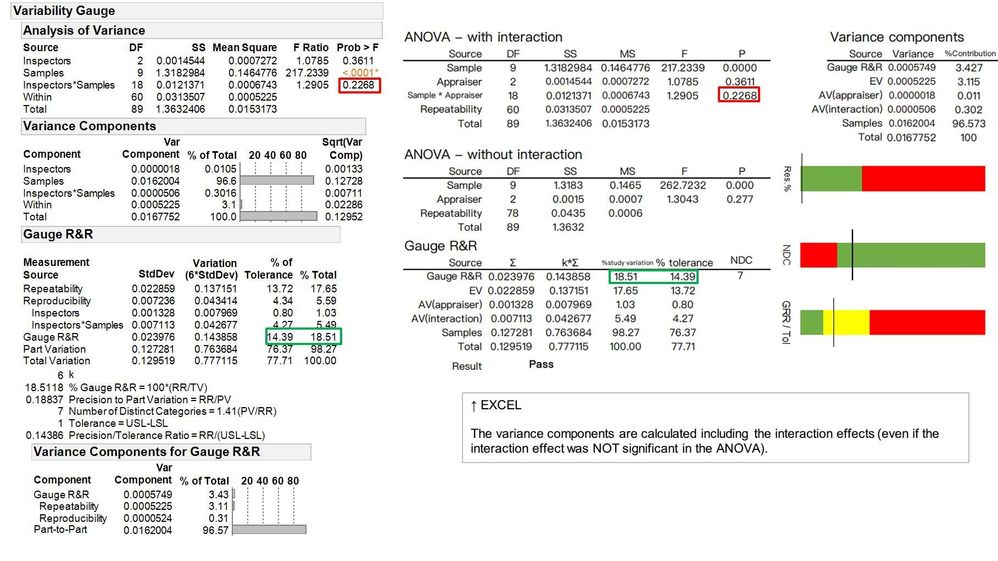

Differences in GRR results between JMP and MINTAB
This problem has caused a long-term confusion and has not been fundamentally solved.

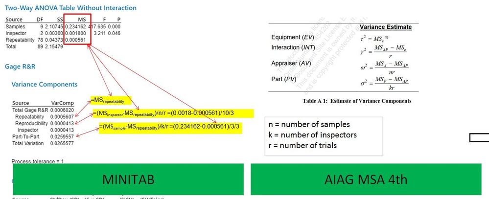

0. The results of the variance analysis are exactly the same, except that the results of the variance components are different. However, MINITAB will perform two variance analyses (with and without interaction).
1. The Minitab's help has the following frmulas for the calculation method of variance components, but it does not explain what method it is, EMS or REML. According to my verification, when a negative value appears, it will be forced to 0. The JMP's help does not explain the specific calculation method of variance components.
2. In JMP, there will be two variance component results as shown in the figure below, and the results are also different. I don’t know why.
3. One thing is certain, the results of MINITAB are consistent with those of the MSA manual.

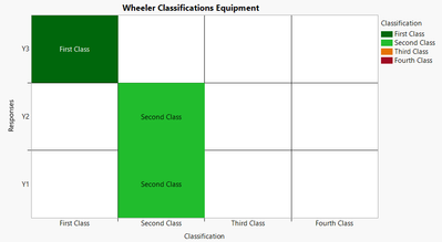

  3. Communication and visualization are key. As mentioned by @awelsh, if you have to communicate your findings (and particularly to non-statisticians/data scientists), I'm not sure providing raw analysis results make sense for them (and comparing results between two softwares at the decimal place is irrelevant for them). The Average and Range/StdDev charts are helpful to detect problems related to repeatability and reproducibility (if any) :
    What the stakeholders want to know are the practical outcomes from your analysis : what are the main sources of variation ? If the equipment/response is highly noisy, on which aspect (repeatability/reproducibility) do they have to focus their effort ? If they have several protocols/responses, how are they performing relative to each others ?
    On this last point, I also like very much Wheeler classes like @awelsh, because with visualization you can very quickly show and rank different responses based on their "information quality" (example here on an anonymized real use case) :
    I find it a lot clearer to understand, compare and rank the different responses.

I know there are three methods: EMS, REML and Bayes. According to the help of JMP, if the data is balanced and there are no negative values, the EMS method will be used. But it still cannot get the same result as MINITAB. You can try it.

1. The formulae you see from Minitab is EMS. And there is no closed form formulae for REML; the REML solution is found numerically.
2. The Var Comp for Gage R&R section in JMP is based on the sum of Variance Components in the Variance Components in the section above.
Repeatability = Within
Reproducibility = Inspector + Inspector*Samples
Part to Part = Samples
And Gage R&R = Repeatability + Reproducibility
How are the Var Comps in Minitab different than JMP?

Thank you very much. I am not a professional statistician. I just want to know how to answer customers when they ask about inconsistent results. The algorithm of MINITAB is consistent with the AIAG MSA manual.
In addition, according to the JMP help description, when the data is balanced and the calculated variance components are not negative, the EMS method will be used. But according to my verification, the results of MINITAB and JMP are always different. Generally, we do GRR with 3 people * 3 times * 10 samples.

Re: Differences in GRR results between JMP and MINTAB
I verified it again. Its interaction effect is not significant.
After forcing the interaction effect to be included in the variance component (even if the interaction effect is not significant in the ANOVA), the results of JMP and EXCEL are exactly the same.
This may be a mistake of MINITAB, because the AIAG MSA manual does not tion "When the interaction effect is not significant, how to...".
