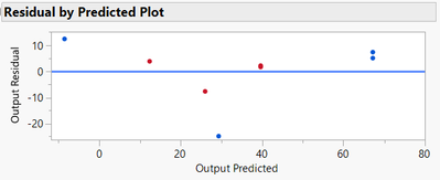

What led you to apply a transform to the output? The Actual by Predicted plot does not exhibit a pattern:
Neither does the Residual by Predicted plot:
The wide 95% confidence interval on Lambda in the transform function includes 1, the identity transform:
You have a small data set with which to evaluate transforms.
