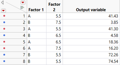

There is something that I have not understood between the difference of the results I get when analyzing a small dataset by using fit model with “standard least squares” and then using the Box Cox transformation menu to do a log transformation (λ = 0) versus using the same “fit model” but this time with “generalized linear model”  with distribution “Normal” and link function “log”.

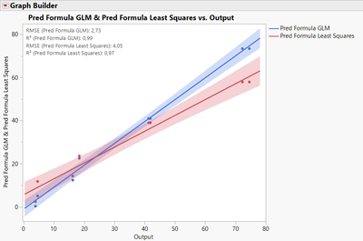

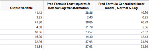

See the results in the table below. I preent the actual response values (clumn output variables), then a second colulmn with the prediction from the method least squares with the log transformation and finally a third column with the results using the method generalized linear model with normal distribution and log link function. You can clearly see that generalized linear model method does better predictions. I wonder why the least squares method with the log box cox transformation do not give as good results (or similar) as the ones by the generalize linear method with normal distribution and Log link function.
I specify that the terms of the model in both cases are the same (two main effects and one interaction). Knowing what the difference between these two methods is and if I can decide using one or the other without restrictions is crucial since if you se the results below the significance of terms are also different in each case. To be honest, the generalized linear method reflects more accurately the real situation we observe. However, I do not exactly know if I can use freely the generalized linear method. I looked in the documentation but found only general information about some nonnormal cases (binomial count etc) where generalized method can be used, but my question is a little bit more precised.

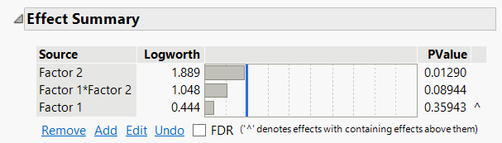

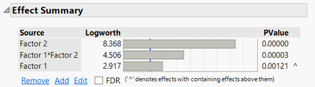

Effect summary for least squares method with Log box cox transformation (λ = 0)
Effect summary for Generalized linear method with normal distribution and log link function

Transforming the response with log is indeed not the same as using a GLM with log link. It's like comparing the average of the log response, versus the log of the average response.
Applying a non-linear (e.g., log, inverse) transformation to the dependent variables not only normalizes the residuals, but also distorts the ratio scale properties of measured variables.
On your example, we can see that using log transformation with a standard least squares model tends to underperform for bigger Y values, as differences in big Y values lead to very small log differences (it "shrinks" the differences because of the log transformation).
Example with rows 1 and 7 (output difference is equal to 30,43), where the difference of the log of the individual responses is equal to 0,237 whereas the log of the difference between the row is 1,483.
Applying GLM and setting up this type of model with link function enable to stay in the original scale of the data, using a link function to transform the mean into a linear function of the predictor variables and a variance function to allow for variance heterogeneity in the analysis rather than trying to transform it away (for example through log transform).

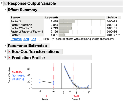

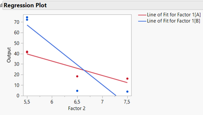

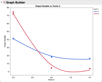

Graphing your data reveals the nature of the model you need to fit to this data. There is a quadratic effect of B that interacts with factor A:
This means that the appropriate least squares model to fit to this data is:
Which gives:

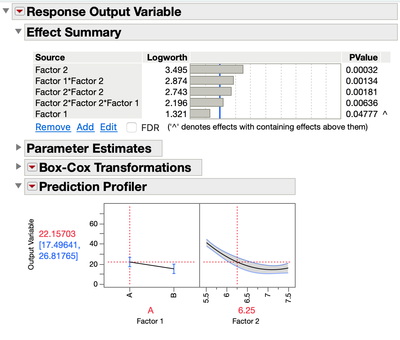

Note the dramatic change in the profiler regarding the effect of Factor 2 on the output variable when switching factor 1 to the B setting:
You will find this profiler looks very similar to that you are getting via your General Linear Model approach which is able to model the nonlinear relationship in your data.
The short answer is: your least squares model and general linear model are not equivalent with regard to their ability to model the curvature in this particular data. Graphing the data prior to specifying the model will help to work out the model to specify in standard Least Squares.

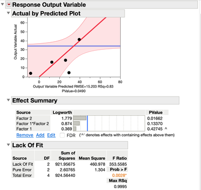

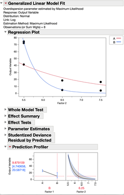

Please look at the profiler for your generalized linear model. This shows your generalized linear model is representing the relationships in your data in the same way as the model I proposed by using standard least squares (representing the effect of Factor 2 as non-linear). If a non-linear effect makes no physical sense then you shouldn't be using the generalized linear model.
Please go back to the least squares model with linear and two factor interaction effects and turn on the option for lack of fit test. You will see evidence of lack of fit:
If the effect of factor X2 cannot be non-linear, then I encourage you to think about what is responsible for the lack of fit. For example is there another factor that was not controlled or measured in your experiment that might also be influencing your output? There is something going on in your process that is not explained by the linear effect of X1, the linear effect of X2, or the interaction effect of X1*X2. This lack of fit is responsible for the poor predictive quality of the least squares model for rows 2 and 4.

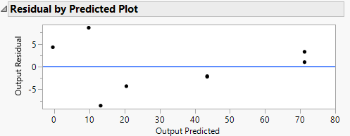

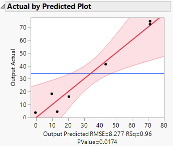

What led you to apply a transform to the output? The Actual by Predicted plot does not exhibit a pattern:
Neither does the Residual by Predicted plot:

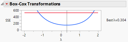

The wide 95% confidence interval on Lambda in the transform function includes 1, the identity transform:
You have a small data set with which to evaluate transforms.
