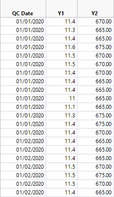

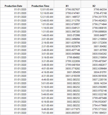

  The issue I have is trying to find the right time lag between QC data that is collected every say, 4 hrs in a day, and production data that is collected on a different time scale. Right now, I am looking at Production data that is gathered every 15 min (this is on things like pump rates, belt speeds, oven temperature, etc.). The QC and production data come from different sources, so I need to join them. I do that, but then get multiple of the same entries for each time from production.
For example,
And so on. The QC data might be something like, and could be collected on an every 4-hour basis or so:

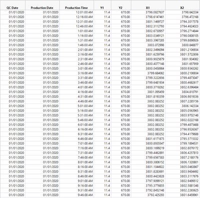

The problem is when I join the data tables, I end up with multiple of the same entries for Y1 for each time point in the X until it changes time. The joined data table will look something like this:

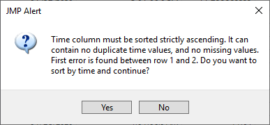

The problem is when I try to run the time series analysis. JMP complains at me with the following:
Which is true, there are duplicate values as these are measurements QC measurements of the product as well as production data, so one would expect to have duplicate values. Plus, because of how the QC data is joined with the production data, there are repeated QC entries for each 15 min of the production data output until the next entry for the QC data.

  I think I found a work-around where I can at least test the cross-correlation between QC data and Production data. After joining the tables, I will have multiple repeat entries of the QC data (since the Production data is collected each 15 min). Using a Row() column as the X, Time ID input and the QC data as Y and Production data as X, then I can generate a cross-correlation table of the QC data with the Production data. The only thing I need to keep in mind is that there will be some correlation in there due to the fact that for several different time events for production, I will have multiple identical entries for QC data. This does result in period structure of the cross-correlation, but it's all due to how the data table has to be joined.
