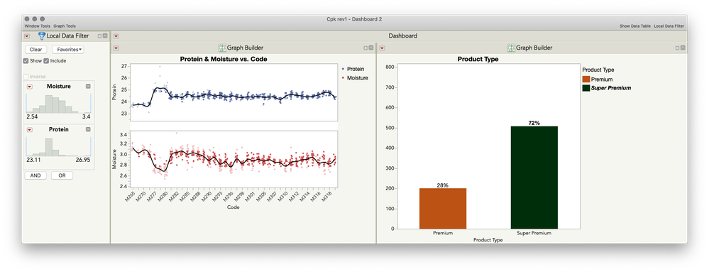

Okay, I've got something for you. Here's what it can look like:
It might say "Local Data Filter," but that's actually a Global Data Filter in that dashboard, and as such, will update row states (selections) when it's modified so that your selection formula operates. How did I do this? One tiny change in the script that JMP generates. But first, I built the dashboard as that video showed:

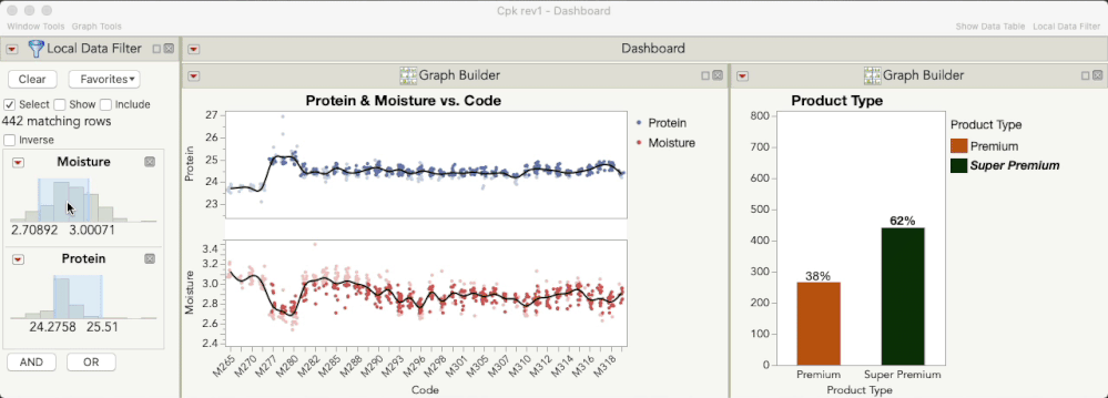

Hi Julian. Thanks for your reply. I only wish it were that simple. I had tried this previously, hence the reason for specifying Global v Local data filter in my query. It doesn't work (as per attached screenshot ) because the LOCAL data filter in Dashboard will simply include or exclude points on the chart for the range of values chosen; it does not 'SELECT' corresponding rows in the data table. As a result, the bar chart will  always stay static at 100%.
However, when I use a GLOBAL data filter outside of Dashboard, the filter selects & deselects rows in the dataset. It also keeps ALL data points on the run chart and only 'ghosts' those that are not selected by the filter. Also, for the data ranges selected in the filters, the corresponding rows are 'selected' in the dataset - this makes the bar chart real-time dynamic. I attach the dataset in case I'm not explaining it clearly.
Next, I ran that dashboard to make your almost-there version with a local data filter:

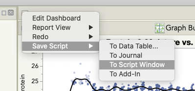

Next, I saved the script of this dashboard to a script window, by using the Red Triangle for the dashboard:
On line 47, you will see the filter being defined:
Change Local to Global, and you're done!
