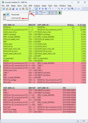

I have written the script and everything runs ok, but:
1) I don't know how to do the last point to a choice Lock Journal by script?
2) I have 2 tables, how I can put the 2 tables in front of each other?

Here is an example of how to lock an outline box
Names Default To Here( 1 );
dt = Open( "$SAMPLE_DATA/big class.jmp" );
jr = New Window( "my jr", <<journal, ob = Outline Box( "box" ) );
ob << append( dt << new data box );
ob << lock( 1 );
