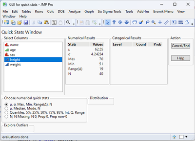

This is the current view of the user interface.

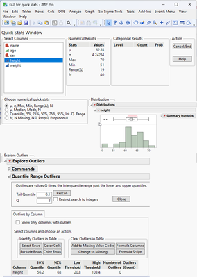

This is the concept of how I'd like it to look like when someone clicks on the column of interest, in this case :height.

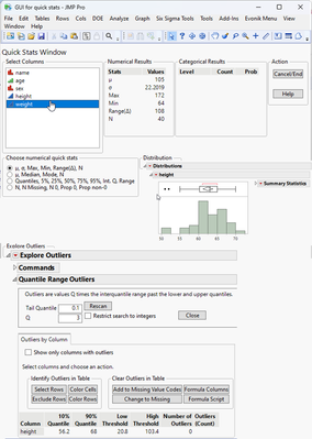

Then, when the user clicks on a new column, say :weight, the display updates and shows this:
