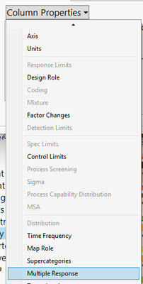

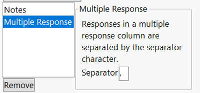

The separator can be specified as Column property:

Thanks so much Hogi - I knew it would be something simple...

Brilliant! I just tried this where the column had been imported from Excel, stacked with ALT+Enter. I did ALT-Enter in the Separator box and it worked!
