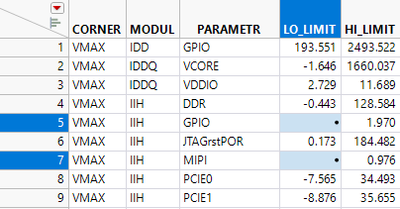

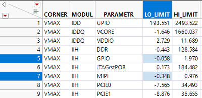

I have table and I would like to delete specific data in cell.
for example with this condition as well:
1) if CORNER = VMAX
2) if MODUL = IIH
3) if PARAMETR = GPIO & MIPI
4) if LO_LIMIT is not 0
Delete the data of LO_LIMIT for these criteria
at the end I would like to receive data table
can you assist me in JSL script for this task?

Build your condition statements and combine them with and/or. Then get rows of interest and use that to clear rows. Below are few a bit different options
Names Default To Here(1);
//option1
rows_to_set_missing = dt << Get Rows Where(:age >= 13 & :sex == "F" &  :weight < 100);
If(N Rows(rows_to_set_missing) > 0,
	dt[rows_to_set_missing, "weight"] = .;
stop();
// option2
Column(dt, "weight") << Set Each Value(
	If(:age >= 13 & :sex == "F" &  :weight < 100,
		:weight
