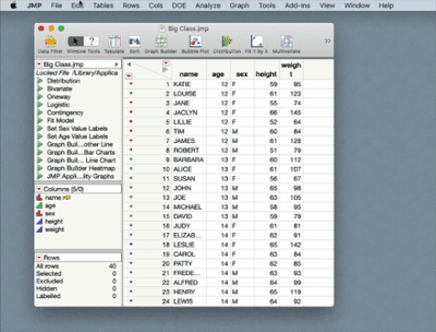

The Row Markers are Row State values in the data table.  So, go to the data table, right click on the area at the top of the Row State Column (the column where the row numbers are), and select "Clear Row States".  That will clear all of the markers and colors.

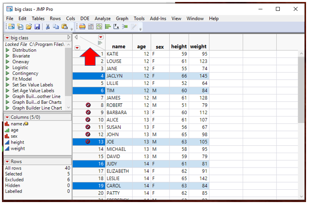

Could you please advise the solution for the case when lots of rows are "hidden & excluded" randomly and the colored markers must be decolorized without touching the hidden-excluded rows, since the option for "Clear Row States" desactivates also excluded values. Yes, I can clear everything and perform excluding values again - this way, however, is not quite rational.
To be brief, how to desativate colors of markers preserving status of excluded-hidden rows? You helped me yesterday a lot, btw.

You can clear all of the selections by simply clicking on the lower half of the square at the top of the Row State Column
