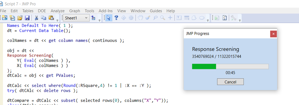

OneNorthJMP
Level V
Re: Delete columns with same value
Hi nelson,
Thanks for advice.  But the response screening is take way too much processing time and it is not ideal. Running 45s and haven't half way finish processing.
