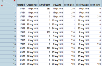

Dear All,
I would like to make a simple calculation but I can not.
Attached jmp table is a subset of Hotel Occupancy Data Base.
Simple logic for Record ID 27421 is;
in 14 Apr 2016 250 Rooms arrive and check in,
in 14-15-16 Apr 2016 those 250 Rooms stay at the hotel for 3 days long,
in 17.04.2015 the 250 Rooms which arrived in 14 Apr 2016 Check Out (Leave the hotel).
I need to calculate the RoomLeave Column (which I filled manually for the purpose)..
Record ID is unique but many more arrivals/stay/leave occur at the same dates with different Record IDs.
Many thanks in advance for any of your support.

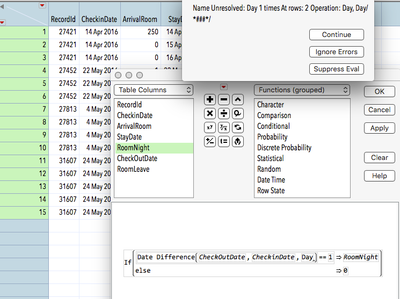

Dear karen@boulderstats​ thank you for the input. Either I did it wrong or the formula itself gives error.
KarenC
Super User (Alumni)
Re: Delaying (lag) a row value by column date
Yes, I didn't provide the exact correct formula.  You got close.  It is the "Day" piece that is tricky. Jim used the same formula in the script he wrote only he has it correct in that you need the quotes around "Day".  With many JMP formula's the options can be tricky (they generally make sense once you see them) so I find I often need the user manual to get all of the pieces correct.

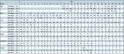

P.S.: Unfortunately the 'day' have to come from the StayDate for the ArrivalRoom and RoomNight but does not fit for RoomCout which needs a +1 day delay (A guest can not stay and Check Out same day). Acc. to my logic it is impossible to solve it in one tabulate report like the one above...
