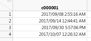

I'm guessing you did something wrong because I was able to correctly import all the values you put as examples.  I pasted them into excel, saved as a CSV, and then imported using the steps I outlined and got this:
-- Cameron Willden

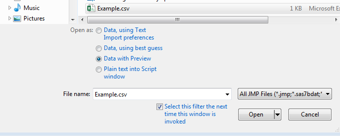

Hi @Artemio,

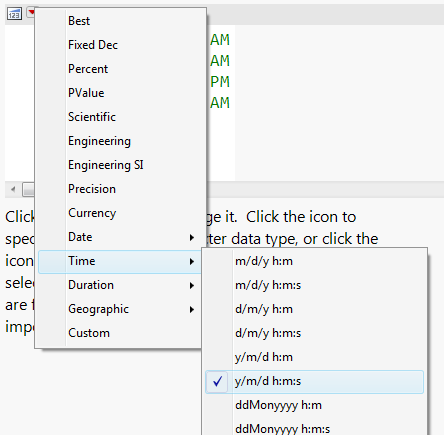

This is actually a pretty simple fix that requires no scripting (though you can script this).  In the absence of direct input from you about the date format, JMP is going to guess.  It very often gets this wrong with 2-digit years.  When you go to open the file, you should see some options like this (at least on Windows):OpenCSV.PNGOpenCSV.PNGMake sure to select "Data with Preview" when you open it so you will have a chance to specify the informat of the date column.  You will see a window that lets you modify the import settings for the csv file.  If you click "Next", you will get to set the informat setting on the next page.

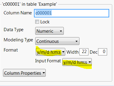

 If you click the red-arrow next to the column with the date format you need to set, you will get the list of informats available.  Select Time > "y/m/d h:m:s".  Now you can import.InformatSelect.PNGInformatSelect.PNG
 If you want to know how to script this import setting, check out the Source script on the resulting data table.
-- Cameron Willden
