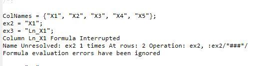

I am trying to apply the log10 function to an entire column within a data table.  The result will be in a new column with a new name.  The new column and name are generated by I get an error in the formula portion.  Below are the results of the script and the error message.

vince_faller
Super User (Alumni)
Re: Datatable indexing Problem within a Formula
Here's just the script.  But definitely the article is more in depth.
Names Default To Here(1);
dt = As Table(J(5, 5, Random Uniform()), <<column names({"X1", "X2", "X3", "X4", "X5"}));
ColNames = dt << Get Column Names(String);
For(i = 1, i <= N Items(ColNames), i++,
    col_name = ColNames[i];
    Eval(
		EvalExpr(// if you just evaluate this block you'll see that the col_name var has been replaced
			dt << New Column("Ln_"||col_name, numeric, formula(
				ln(Expr(Column(dt, col_name))[])
Vince Faller - Predictum

jthi
You need to evaluate the column name into the formula. This is a good post about it Insert one expression into another using Eval Insert, Eval Expr, Parse, and Substitute
