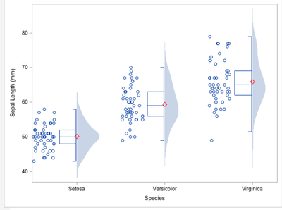

Dear all,
does anyone know if with JMP it is possible to create a graph showing the box-plots with the points inside each box and showing half of a violin plot.
In practice, a graph similar to the one attached, but with the points inside each box-plot.

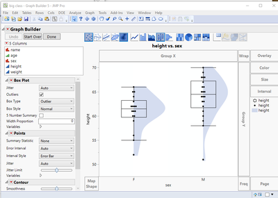

I don't know a direct way of getting Graph Builder to do the half Violin chart, except to add a rectangle to hide half of it.  But here is an example
Names Default To Here( 1 );
// Open Data Table: big class.jmp
// → Data Table( "big class" )
dt = Open( "$SAMPLE_DATA/big class.jmp" );
gb = Graph Builder(
	Size( 570, 510 ),
	Variables( X( :sex ), Y( :height ) ),
	Elements(
		Box Plot( X, Y, Legend( 6 ) ),
		Points( X, Y, Legend( 7 ) ),
		Contour( X, Y, Legend( 8 ), Adapt to Axis Scale( 0 ) )
Report( gb )[FrameBox( 1 )] << Add Graphics Script(
	5,
	Description( "" ),
	Pen Color( "white" );
	Pen Size( 2 );
	Fill Color( "white" );
	Rect( -.5, 75, 0, 40, 1 );
	6,
	Description( "" ),
	Pen Size( 2 );
	Rect( .5, 75, 1, 40, 1 );
Report( gb )[FrameBox( 1 )] << Reorder Segs( {1, 2, 10, 11, 5, 6} );

The Essential Graphing document covers the usage of Graph Builder.  For the adding of a graphics script, that documentation is in the Scripting Guide, with the functions detailed with examples in the Scripting Index.  All of these are available under the Help pull down menu.
The Add Graphis Scripts that I added to the base Graph Builder simply places a white rectangle over half of the violin plot, using a rect() function.  Rect() draws a rectangle.  This is detailed in the Scripting Index.  The values are (left, top, right, bottom, and should the rectangle be a filled or empty rectangle).  Since the X variable is a nominal(character) variable the x coordinates for each of the values in X start at 0 and are incremented by 1.  This determines the Left and Right values for the rectangle.  Typically the top and bottom values are set by the Col Min() and Col Max() values for the Y column.
There will have to be 1 Add Graphics Script section for each of the values of the X variable.
The Reorder Segs sets the order the various components of the chart and which front  to back order they should have.  One needs to have the rectangle object in front of the violin, but behind the box plot.
Jim
