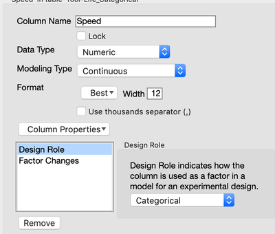

For #1, if I sent the factors up as 3-level continuous but set the 'Design Role' to categorical, the model still appears to be fit as a continuous variable coded -1 and +1 for the low and high values. The middle level (the one that's actually different) is effectively coded 0 and not used in the effect calculation. If it's set up as a 3-level categorical, then the model outputs what I would expect with an effect calculated for each level, recognizing that the middle level is different from the other two.
If I know that I want to do one analysis that's an effects model with categorical variables then transition to fitting a response surface with continuous variables, what is the best practice workflow? Set up two different data table with different data types altogether?

Thanks so much for the quick reply. This is really helpful. Does changing the Design Role for a continuous data type have any impact in Fit Model? It seems not, because a continuous data type with a design role of categorical is still fit like a continuous variable. I just want to make sure I'm not missing something.

We have JMP Pro 15. I think I'm mixing up 'Modeling Type' vs. 'Design Role'. I had the data type and modeling type set to 'numeric and 'continuous' but the Design Role set to 'categorical'. The model type is what I need set to nominal, not the design role to categorical to get an effects model.
