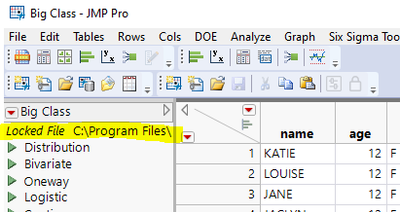

Is the file locked? If so, you cannot save the locked file. It might be locked for a number of reasons, but on a shared drive, it might mean that the file is open by someone else.
Here is a thread on some troubleshooting: Check if table is read-only?
