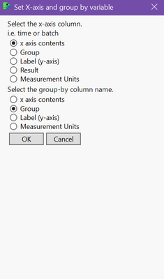

I have been having an issue with my JMP script not reading the selected Group-by variable from the user selection in the modal window. I want the user to select a "group by" column name from the data that could be any group-by variable and have a legend and coloring scheme as in the example below.
In the attached JMP data table, my toy data has the generic "group" column. But, a user should be able to select any character variable (such as mfg site, batch, process, formulation) from the table and have the group-by legend and coloring scheme.

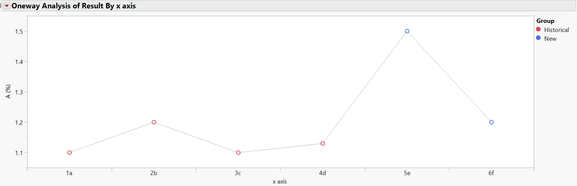

In this JMP script, the x-axis column selection works (see the modal window example and the resulting graph below), so I assumed that the group-by variable reference will also work as well. But the output produces a graph that does not have any group-by variable or legend. What is my code doing incorrectly here?
Modal Window:
