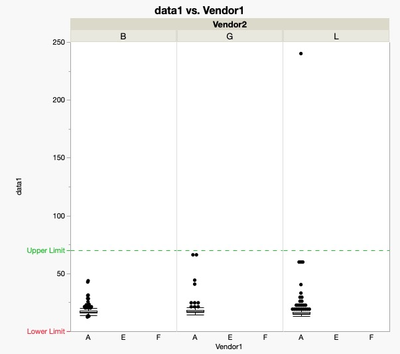

I am new to JMP and encountering issues exporting multiple box plots. My goal is to create plots with X-axis variables grouped by another parameter. However, the exported output is missing some X-axis data, even though the plots are correct when I use a single specific column.

And this is the picture with missing data:

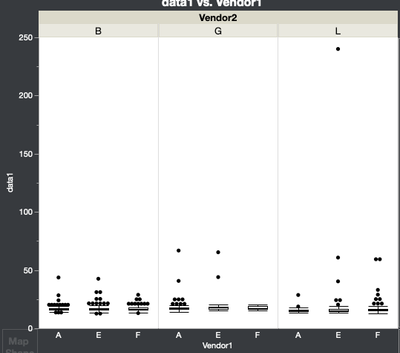

And no issue when I drew by the UI directly:

My initial guess is that your graph builder is being built incorrectly in your script (make sure you compare your script to the one you get by manually creating the graph). The Elements part is most likely incorrect for Box Plot
	bp = dt << Graph Builder(
		Show Control Panel(0),
		Show Legend(0),
		Variables(
			X(:Vendor1),
			Y(Eval(col)), // Box plot for the current column
			Group X(:Vendor2)
		Elements(Box Plot(X, Y, Legend(1))),
        // Add Reference Lines for Limits
		SendToReport(
			Dispatch({}, colName, // Use the column name to target the Y-axis scale,
				ScaleBox,
				{Add Ref Line(upperLimit, "Dashed", "Green", "Upper Limit"),
				Add Ref Line(lowerLimit, "Dashed", "Red", "Lower Limit")}
Also I would consider modifying your data in such a way, that you remove specification limit rows as that isn't really how you would like to have your data. You can store them into a variable, set them as column properties or maybe store them to table variables.

Your Elements specification needs to have the X variable selected as well as the Y variable.  Your code does not have it checked
Change the Elements specification to
Elements( Box Plot( X, Y, Legend( 1 ) ) )
		Show Legend(0),
		Variables(
			X(:Vendor1),
			Group X(:Vendor2)
		SendToReport(
				ScaleBox,
-Jarmo

Yes, That is the issue...lol! Thanks for help and will examine all the details next time...
I've confirmed that limit values aren't included in the reference drawings. I'm still try to understand why, and I'll examine more results. Currently, the only way I know is to separate limit values with a new data table and refer to the limit data table with additional loop code, which is complicated for me.
