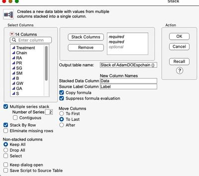

Have you tried multiple series stack? You can stack many columns.

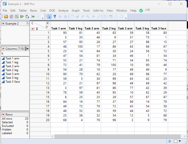

I'm not clear that that function will work. Right now my data are analogous to:
Task 1 arm; Task 1 leg; Task 2 arm; Task 2 leg; Task 3 arm; Task 3 leg; Task 3 face
Except that the variable names diverge from the format above and aren't all consistent. I want to stack the Task 1 values, and also separately the Task 2 values, and also separately the Task 3 values, but all joined by the Body Site variable:

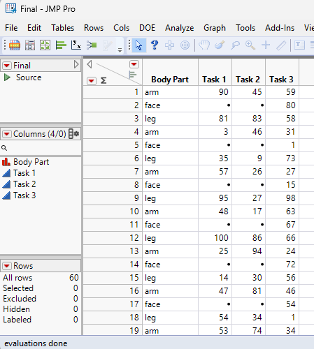

txnelson
Re: Stacking multiple variables
A script can be written that will test for the different variations in a column name, and then change the name to the standard form.
Once in the standard form, as you describe the names, the following script takes the standard form
And convert it into the new form for the table
names default to here(1);
dt = new table("Example",
	add rows(20),
	New column("Task 1 arm", set each value(random integer(1,100))),
	New column("Task 1 leg", set each value(random integer(1,100))),
	New column("Task 2 arm", set each value(random integer(1,100))),
	New column("Task 2 leg", set each value(random integer(1,100))),
	New column("Task 3 arm", set each value(random integer(1,100))),
	New column("Task 3 leg", set each value(random integer(1,100))),
	New column("Task 3 face", set each value(random integer(1,100)))
dt << new column("Row", set each value(Row()));

dtFinal = dtStack << Split(
	Split By( :Task ),
	Split( :Data ),
	Group( :Body Part, :row ),
	Output Table( "Final" ),
	Remaining Columns( Drop All ),
	Sort by Column Property
dtFinal << Sort( By(:row, :Body Part), Replace Table(1));
dtFinal << delete columns(:row);
dt << delete columns(:row);
