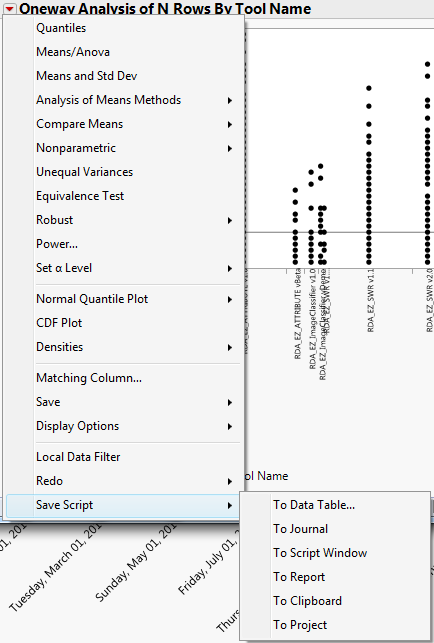

In previous version of JMP there was a 'Data Table Window' option in the menu that isn't there in JMP 13.  Ctrl+Alt+D is the shortcut to pull up the data table, but this doesn't work on private tables.  Is there an easy way to make a table show up in JMP 13?
Unfortuneately, I no longer have JMP 12 installed as of this week so these little annoyances are no longer little.  If you know anything please respond! Thanks!
No Data Table WindowNo Data Table Window

The JMP 12 'Script' menu was split into the new 'Redo' and 'Save Script' menus in JMP 13.  The 'Data Table Window' option does not fit well under these, but it does appear in the 'Redo' menu if there is more than one report in the window.

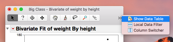

If you have only a single report, I would suggest using the toolbar option 'Show Data Table' on Mac:

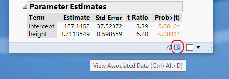

or the status bar icon on Windows:

Investigating a little more: Like you said, the Redo only shows the Data Table Window option if there are multiple reports, and it will show private tables.
The status bar icon doesn't show the button when you have a private table, so works the same as the shortcut Ctrl+Alt+D.  You can also find this option under View -> Associated Data.
The most consistent way I found is to use Window -> New Data View.  (Just a note: This button makes the table visible if it's private or invisible, but will create a new table/view if the table is already visible.)
