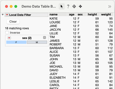

then manually select 'sex' as the filter, the table box is filtered correctly.
However, uncommenting lines 7 & 9 and running, the filter doesn't do anything:
Is this expected, or am I missing anything?
[Using JMP 17.2]

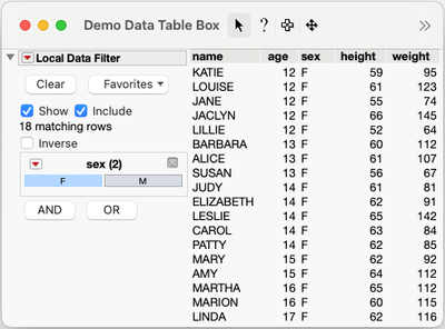

I'm not sure if it's a feature or a bug, but I usually send messages to filters after I've created them. The script below works as you intend, I think.
Names Default To Here( 1 );
nw = New Window( "Demo Data Table Box",
	Data Filter Context Box(
		H List Box(
			dtf = dt << Data Filter(
				//Show Controls( 0 ),
				Local,
				//Add Filter( columns( :sex ) )
			dtb = data Table Box( dt )
dtf << show controls (0);
dtf << Add Filter (Columns (:sex));

Re: Data Table Box with local data filter
I would consider this a bug, and it will be fixed for a future JMP release.  Thanks @Jed_Campbell for the workaround - that is a reasonable solution to ensure that the filter connects to the Data Table Box.
