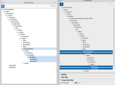

Tree Structure of the Data Filter in JMP17Tree Structure of the Data Filter in JMP17
However, in JMP19, the Tree Structure of the Data Filter changed : the LineUpBox() has been move upward and the parent of the columns is a List Box() that does not have N Col() and Spacing() functions. I can do the function << Set Horizontal(1), but I am limited on one line only and the display is not great.

Tree Structure in JMP19Tree Structure in JMP19

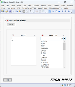

Below is an example with two columns (but in reality I can have more). It will work in JMP17 (the two columns are displayed horizontally) but not in JMP19.
Window from JMP17Window from JMP17

I don't think there are any easy solutions that you can get to by just modifying the display boxes. Data Filter structure change has also broken few UIs in my add-ins I manage at work but for a different reason and it will be (hopefully...) easier to deal with than trying to organize filters into a grid.
JMP18 on the left and JMP19 on the right
