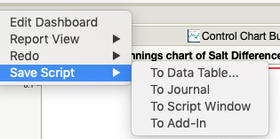

From within the dashboard click the top most red triangle and select Save Script >>To Script Window
Save Script to To Script WindowSave Script to To Script Window

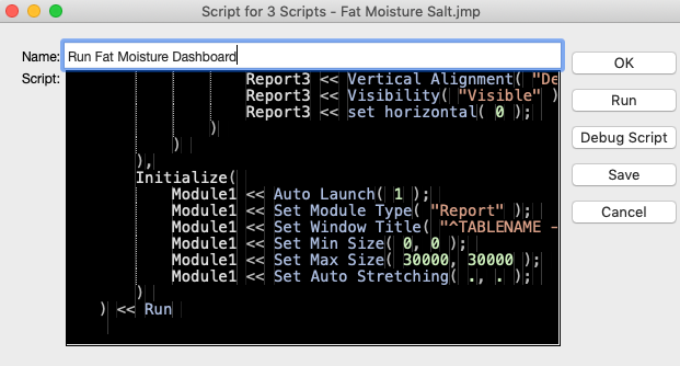

Finally, then back in the data table you can click on the red triangle and select New Script.
Select New ScriptSelect New Script
And paste the contents of the clipboard using Edit Paste or ctrl+v (Mac Command+v) into the Script section.
Provide a name for the script and click "OK"
New Table ScriptNew Table Script

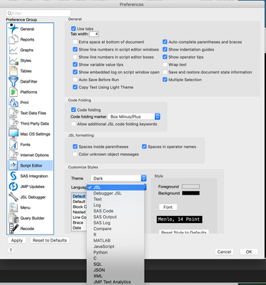

PS: For the curious I am using the new JSL dark theme coming out in JMP 15 ( to be released fall 2019).
JSL Dark ThemeJSL Dark Theme
