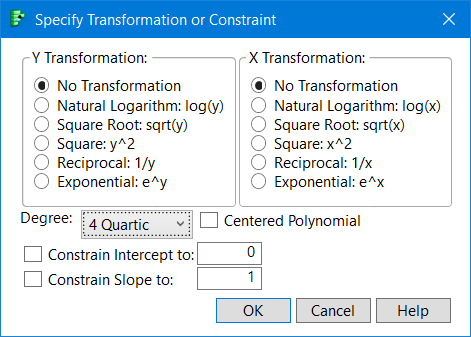

If you are using the JMP UI and using JMP Fit Y by X, then select Fit Special and the dialog window below will appear:
  • uncheck Centered Polynomial
  • Select Quartic for a 4th order polynomial

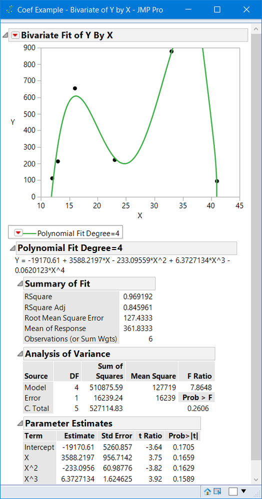

coef_vec = Report(biv )["Parameter Estimates"][NumberColBox(1)] << Get as Matrix;
eqn_txt  = Report(biv )["Polynomial Fit Degree=4"][TextBox(1)] << get text;
show(coef_vec, eqn_txt);
coef_vec = [-19170.6096344096, 3588.21966043696, -233.095589066526, 6.37271344368134, -0.0620122936283627];
eqn_txt = "Y = -19170.61 + 3588.2197*X - 233.09559*X^2 + 6.3727134*X^3 - 0.0620123*X^4";

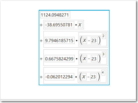

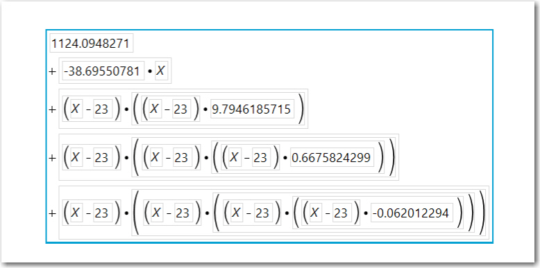

Additional solutions:
If you use Fit Model, click the red triangle in the top left corner of the launch dialog and de-select Center Polynomials.
If you saves the fitted centered model as a column formula, open the formula in the Formula Editor, click the red triangle above the formula and select Simplify.

Hi Mark. Just a quick additional note to the readers, that Save Predicted for Fit Y by X, centered Polynomial, quartic, saves the centered model. However, it is the power formula vs. nested multiplication formula saved by Fit Model. Simplify does not expand and simplify the power formula, and as you stated in your post, Simplify will create the uncenterd formula from the nested multiplication formula.
