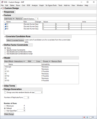

Hallo,I have three  factors. for each one i have 3 Levels .I want to make a Design with only 9 runs .Can you please tell me how to do this.Thank you in advance.

Hello, did you check out the DOE -> custom design platform?
Re: DOE
Have you tried the JMP guide for DOE? There is a lot of information to get started quickly. There are examples to go with each topic.
Also, there is more to experimenting than combinations of factor levels. The most successful experiments result from the considerations of the nature of the response and factors and the test environment.
