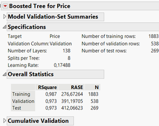

Here is an example of the results with a stratification validation column on the Diamonds Dataset with "normal" (not fine-tuned) Boosted Tree :

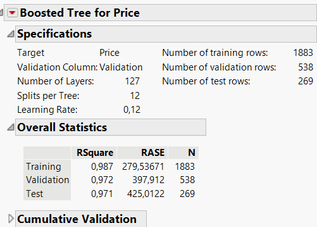

And here is the results by using a Tuning table :

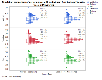

Here there are no big changes between the "default" settings in JMP and the fine-tuned version of Boosted Tree, but it may be helpful and interesting to try the fine-tuning to evaluate the performances changes. You can also evaluate the "robustness" of your hyperparameters fine-tuning if you have used a validation formula column (right-click on Rsquare, RASE or other evaluation metrics, and use "Simulate" to switch in and out the validation column, and set a random seed in order to have reproducible results for the comparison) :
Once again here, it doesn't make a big difference, as the default settings in JMP are good and quite robust, but you can try for yourself.
