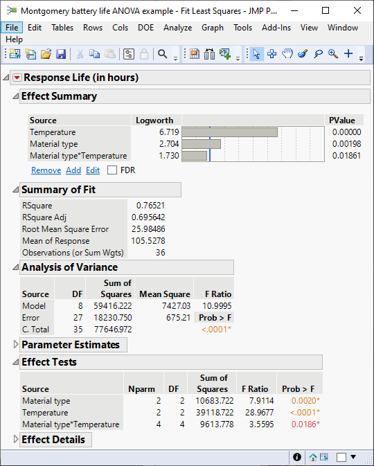

The problem is that you set the modeling type of Temperature to Ordinal. I would use Continuous. But Montgomery used Nominal for both Material and Temperature. When I change the modeling type to match, I get the same result:
I just verified that the data in your data table match the data presented in Doug's book.

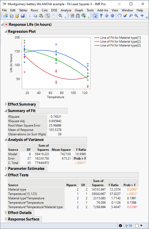

If I set the modeling type of Temperature to Continuous then I'm doing linear regression, with slopes and intercepts, and interactions between a linear effect and an attribute effect.  There is then one degree of freedom for Temperature, plus loss of degrees of freedom for interactions between Temperature and Material Type.  That is not what Montgomery did.  Why do the calculations for JMP differ from Montgomery.  Montgomery's demonstration is plain-vanilla ANOVA with two factors each at three (attribute) levels.
If you look at @Mark_Bailey 's latest example, the JMP output is the same.  To have JMP give you plain-vanilla ANOVA based on two categorical factors, set both of the factors to nominal and the default ANOVA table will agree with Montgomery.

Doug was illustrating how experimenters and statisticians thought about the analysis 100 years ago when factorial designs were introduced. It is still valid, but it is not the only way to think about it. It is a balanced design and treats all factors as if they were nominal categories. Again, that is still valid but only one way. Why did they do it that way? It was the only way available to them at the time. So that they could perform the analysis by hand. A 'computer' in the 1920s was a job title - no kidding. Modeling the data this way allowed people to compute the simple sums that Doug shows by hand.
Today we use computers and software to perform regression analysis. We can realistically treat Temperature as a continuous effect. We can specify the linear model in very flexible terms and then compute an optimal design for estimating the parameters or the response. The design is fixed in this case but I can propose other modeling types and terms. Here is one possibility:
It might require additional runs to verify one of these models as accurate.

The book contains JMP output.  Temperature has two degrees of freedom, so it's not being treated as continuous.

For sure the setting of Nominal data type caused the difference to Montgomery.  What I'd like to learn is how sums of squares are calculated for nominal factors.
