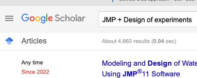

Byron_JMP
Staff
Re: DOE approach
Use Google Scholar and Google DOE, or more specfically JMP, DOE. Its getting diffcult to keep up with the number of papers that use DOE in my field. In general the use of DOE in academic publications has grown alot.
About 4,660 results in 2022
JMP Systems Engineer, Health and Life Sciences (Pharma)
