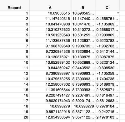

2- Is there any formula based approach (even if script, this needs to be in a formula) that can be used ? I am attaching 2 samples below - same calculations, one in JMP and the other in xls.
A is a free input col.
B initializes to A for record = 1 , and then  is either A or prior value of B ( ie. itself using lag function) dependent on C
C is A - prior value of B
thanks.

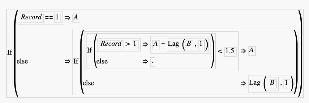

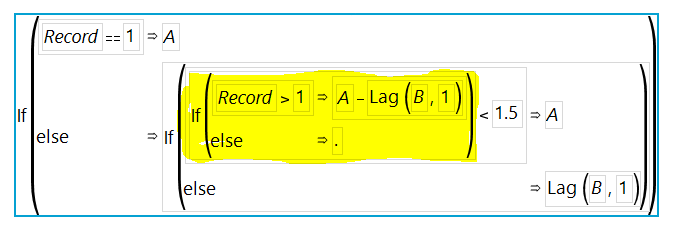

As a workaround, the fix is to not create even the appearance of a dependency by copying the entire formula for column C, and replacing references to C with that formula in Column B:
If( :Record == 1,
	:A,
	If( If( :Record > 1, :A - Lag( :B, 1 ), . ) < 1.5,
		:A,
		Lag( :B, 1 )
You can keep your formula for C as it is, and your table will populate just fine. This doesn't raise the alarms for a cycle because, in a single formula, it is clear to JMP that references to B in the column formula for B are happening through Lag(). It seems when the formulas are in different columns, the cycle detection fails to take the Lag() into account and just sees B referencing C referencing B.
I hope this is helpful for your work until a fix of "Ignore All Cycles" can happen!
