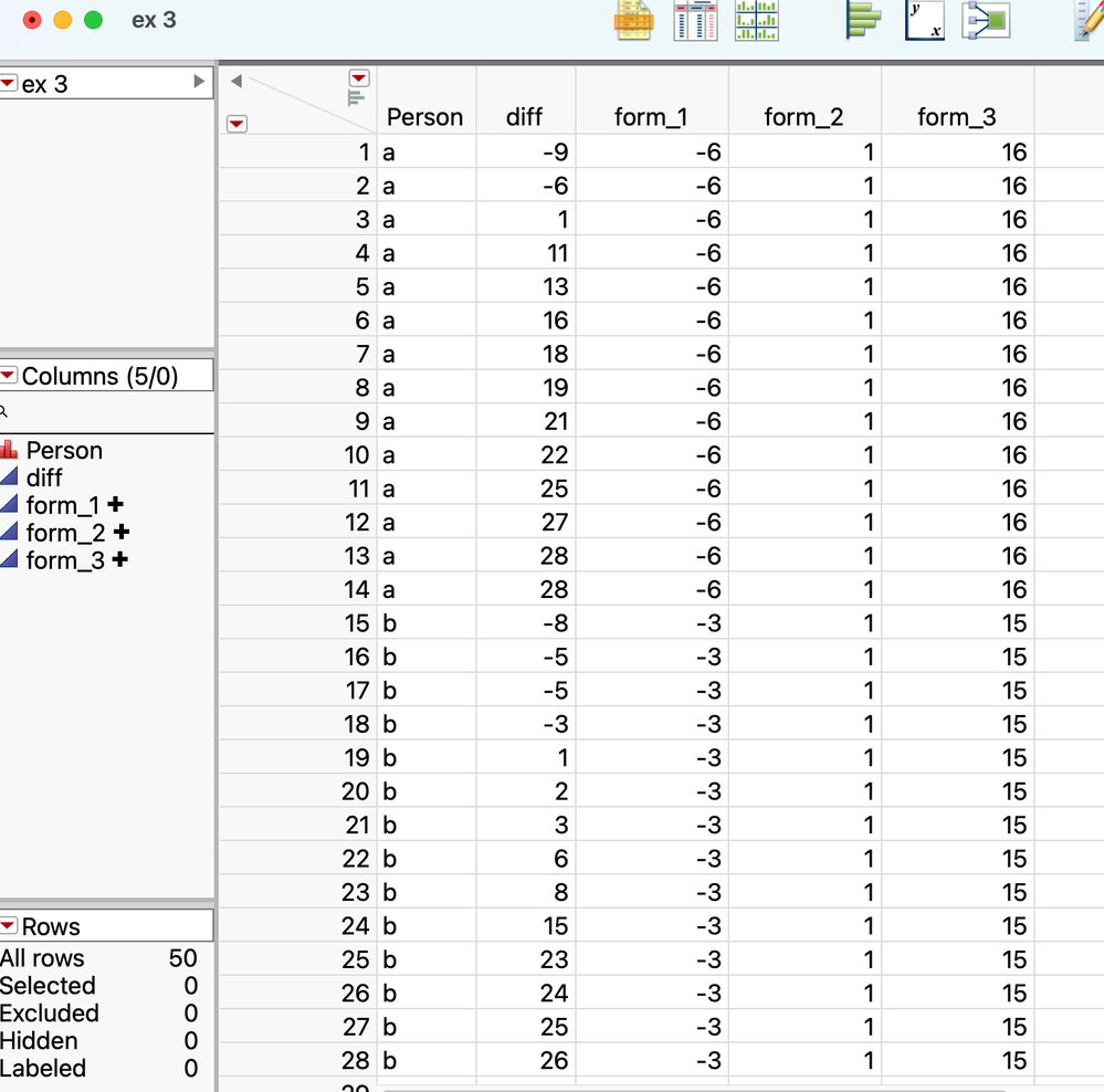

Running the code you will see a table like the one below. In my code, the grouping column is the "person" column... and I've just simulated the differences, as from your description that's the column of interest.

dt << New Column( "form_1", formula( Col Max( If( :diff > 0, ., :diff ), :Person ) ) );
dt << New Column( "form_2", formula( Col Min( If( !(0 <= :diff <= 14), ., :diff ), :Person ) ) );
dt << New Column( "form_3", formula( Col Min( If( :diff < 15, ., :diff ), :Person ) ) );
