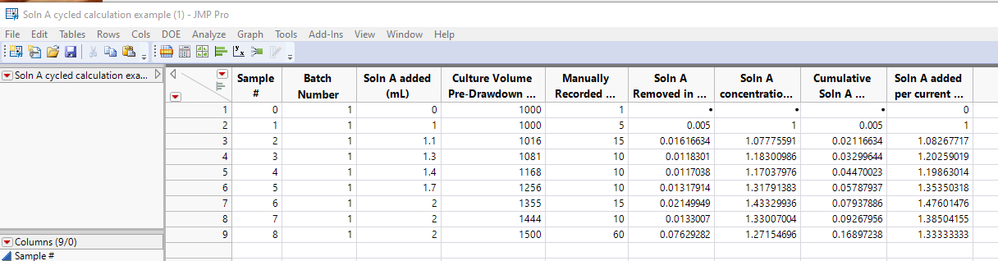

I know JMP is not a spreadsheet and I might need to calculate this differently than I would in excel, but I cannot figure out the workaround.
I have a calculation where a variable is relying on itself and that gives me a "cycle detected for data column" error
I have a tank that has solution being added in over time. I know how much I have added and the tank's total volume. I also take volume out of the tank at sample times. I need to calculate how much of solution A is being removed with each sample volume. But I can't figure out how to do that without getting this cycle error. Please help!

txnelson
Super User
Re: Cycle Detected in calculation
The issue appears to be that the column value for "Soln A concentration before draw (mL/L)" was always getting set to a missing value.  In JMP adding together two values where one of them is a missing value always results in a missing value.....which can be over ridden by using the Sum() function.  Here are the results I get after the change.  The changed JSL is below

I tried your method on a slightly different table (i only added the bach number column, but I think the issue is still there. Instead of an error message I get blank cells. Is there any workaround to allow a variable to rely on its last value?
