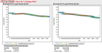

I currently have a script to produce the following plot. The call that finally produces it looks like this:
chart = Bivariate( Y( :Log10 Reads , :Log10 Writes ), X( :Bin ), Nonpar Density,
  Send To Report(
  Dispatch( {}, "Bivar Plot", Framebox, {Frame Size(plotWidth, plotHeight)}),
  Dispatch({}, "1", ScaleBox, {Format("Best", 10), Min(xMin), Max(xMax), Inc(xInc),
                                 Minor Ticks(1), Rotated Labels("Horizontal")}),
  Dispatch({}, "2", ScaleBox, {Format("Best", 10), Min(yMin), Max(yMax), Inc(yInc),
My question is simply, how do I programmatically change the title of the grouping of bivariate plots (circled below) to something customized and more descriptive?

If the report is the top open report this should work:
Current Report()[Outline Box( 1 )] << set title( "my plots" )

Re: Customizing the title of a set of plots
