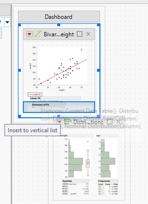

Instead of double-clicking to add a report, drag from the Source list into the workspace and hover near the bottom of an existing report to create a vertical layout:

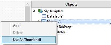

  4. Right click on Module1 and choose Use As Thumbnail - this will capture a picture of the layout to be used in the template picker:

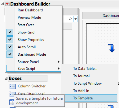

  6. From the main red-triangle menu, Save Script > To Template
