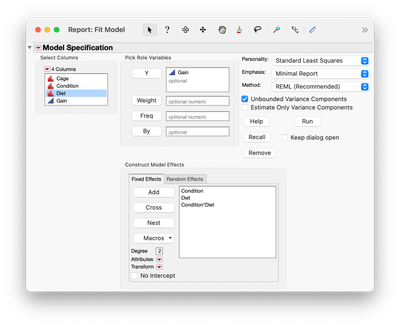

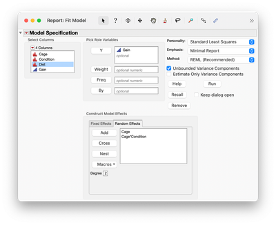

Hello,  I tried to reproduce a nice Design in Chapter 4 of Elizabeth A. Claassens book "JMP for Mixed Models" using JMP DOE Custom designer. But I failed and don’t know why/how to solve it.
The design itself is straight forward: There are 6 cages. Each cage can be divided into two areas. An area can be set to one of 4 condition. Each of the areas is big enough to hold space for 3 different nests. Inside a nest the mice will be attributed to one of 3 different diets.
The experiment is set up to learn how the mice gain weight depending on condition and diet. These are the fixed effects.
The interesting part is the fact that cage*condition shall be treated as a random effect as it is the  actual experimental unit. I added two pictures to show the evaluation.

Hi @Olaf,
Looking at the use case, the design seems to be a split-split plot design (since "Condition" is nested into factor "Cage"), with :
  • categorical factor "Cage" set as "Very hard to change" (with 6 levels)
  • categorical factor "Condition" set as "Hard to change" (with 4 levels)
  • categorical factor "Diet" set as "Easy to change" (with 3 levels).
More infos here : Designs with Randomization Restrictions (jmp.com)
Specifying 6 whole plots and 12 subplots for 36 runs, you should get the same kind of table as the one you have shared (see table "Custom-Designer-and-Random-Effects-Desingn-Evaluation-and-Random").

However, there will be some redundant columns in the analysis and model, as the whole plots correspond to the "Cage" factor, and subplots correspond to the "Condition" factor.
So when launching the analysis, you may have to specify the model manually in order to correspond to the analysis you have :
  • Fixed effects : Condition, Diet, Condition x Diet
  • Random effects : Cage, Cage x Condition
I have saved the script to launch this model in the "Fit Mixed Model" script in the datatable.
