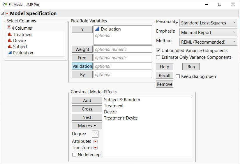

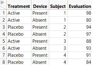

So I mocked up your data:
This set up allows me to specify this model for the analysis:

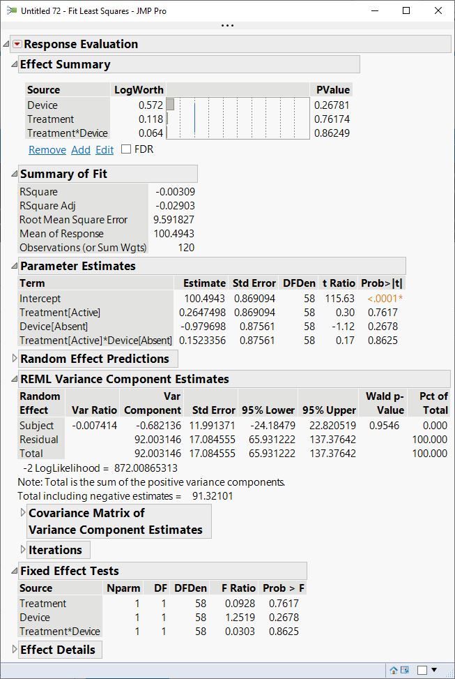

There are no fixed or random effects in the simulated response in this mock up. The results available are:

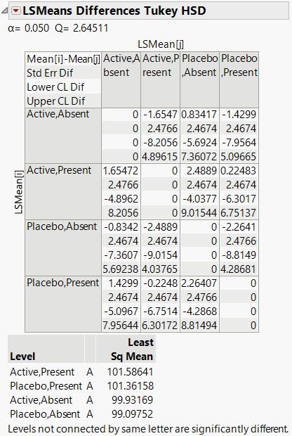

Multiple Comparisons: open the Effect Details outline, click the red triangle next to the interaction term Treatment*Device, and select LSMeans Tukey HSD.

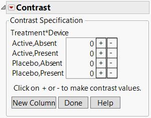

Contrasts: open the Effect Details outline, click the red triangle next to the interaction term Treatment*Device, and select LSMeans Contrast.
Use this interface to define one or more specific contrasts (tests) and the joint contrast.

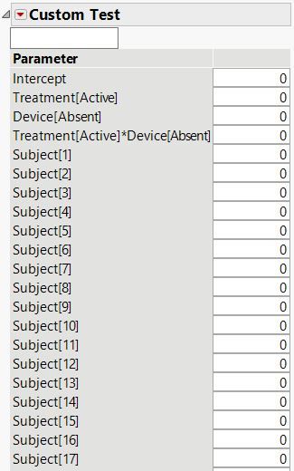

Custom Tests: click the red triangle at the top of the platform, and select Estimates > Custom Tests.
Use this interface to construct one or more custom tests and the joint test.

My understanding is that my primary interest is in the Tukey HSDs report where I believe the LSMeans Differences table has a red arrow that allows the "Ordered differences" report.  In the Ordered Differences report it lists each comparison of the differences between the means along with the p-value of the test.  This p-value is the summary statistic of the test comparing the two means.  Sound right?
