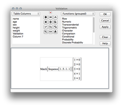

Maybe this will help? I used Sequence() to count from 1 to 5 (with step size of 1, and repeating each value 1 time), and placed the sequence in a match function to recode 1, 2, and 3 as 0 (for training), 4 as 1 (for validation) and 5 as 2 (for test), which will fit your .6, .2, .2 setup.
JSL:    Match(Sequence(1, 5, 1, 1), 1, 0, 2, 0, 3, 0, 4, 1, 5, 2)
7454_Screen Shot 2014-10-20 at 11.38.48 PM.png7454_Screen Shot 2014-10-20 at 11.38.48 PM.png
I hope this helps!

Alternatively, you could use a random integer function rather than sequence, but using sequence will ensure proportions more close to what you define (since a sequence is predictable and a random integer, well, isn't). But, the above could be seriously problematic if, for some reason, there is something systematically biased across the sequence (like every 5th observation being different in some way due to the measurement system, which would mean ALL your "test" data would be of that type). Probably unlikely, but not great. A quick random shuffle of rows would solve that problem.
Julian
