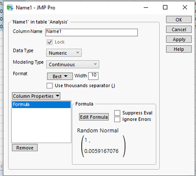

Re: Creating a table with formula in the columns - Random Normal() - from external jmp
Thanks! It worked with this code right below. And it helps me a lot!!

And the new generated table has correct calculated values. However, if I look inside the Formula then it contains the expression from the script.
I can mask this fact by using Set Each Value(). But it makes me crazy ... :)
And now I'm obsessive to understand why the expression is not evaluated properly. I didn't success using Eval () Eval Expr() and Expr(). I believe to undestand their functions but with combination with Formula, no chance.
