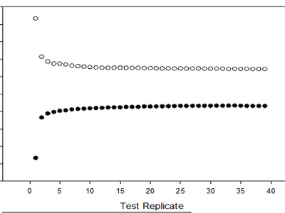

I have a set of data in two columns.  Column one contains a Run ID while Column 2 contains data generated by the run.  My end goal is to plot the 95% prediction interval of the confidence intervals produced by N, N-1, N-2, N-3... until you only have two datapoints per Run, where N = initial number of replicates.  Therefore step by step, If for example I had 40 replicates per run, I would like for JMP to randomly select 39 replicates for each run, conduct a lower 95% and upper 95% confidence interval for each Run, then conduct a lower 95% Prediction interval for the lower 95% confidence intervals of each run and a upper 95% prediction interval for the upper 95% confidence intervals of each run.  This would get repeated with 38 replicates, 37 replicates... until there is only 2 replicates.  I would like to graph on the x-axis the replicate number and plot both the upper 95% Preidiction interval and lower 95% prediction interval similar to what is shown below:

I believe I have an answer for you.  It makes use of the Bootstrapping functionality in JMP Pro, and for that reason will only work with JMP Pro.  Please take a look and let me know if it does what you are after.

	graphdt = New Table(); //create new table to generate GB report
	lowCLcolumn = graphdt << New Column( "Lower Confidence limit" );	//column of lower confidence limits
	graphdt << add Rows( N Items( lowCL ) ); //add rows
	lowCLcolumn << Set Values( lowCL ); // set values from lowCL into column
	upCLcolumn = graphdt << New Column( "Upper Confidence limit" );	//column of upper confidence limits
	upCLcolumn << Set Values( upCL );//set values from upCL into column
	Nsimscol = graphdt << New Column( "N" );	//column of number of rows in simulated estimates table that were not exlcuded (x-axis of GB report)
	Nsimscol << Set Values( nsims ); // set values from nsims into column
	//create GB report
	gb = graphdt << Graph Builder(
		Size( 531, 456 ),
		Show Control Panel( 0 ),
		Variables( X( :N ), Y( :Lower Confidence limit ), Y( :Upper Confidence limit, Position( 1 ) ) ),
		Elements( Line( X, Y( 1 ), Y( 2 ), Legend( 7 ) ) )
