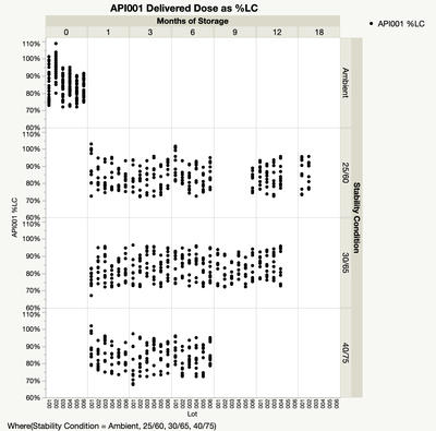

I am trying to use Graph Builder to visualize stability data. I have run into two issues with the existing data table and Graph Builder script/report that I would appreciate any suggestions to address!
In this first case, I need to create a temporary data table that reassigns the stability condition "Ambient" as "0 month" data at each of the other stability conditions (25/60, 30/65 and 40/75). In the report below, you can see that Ambient is in its own category which is an awkward way of thinking about initial testing results. I do not want to change the actual data table that a user would input data into; I am only trying to graphically replicate the t=0 Ambient data for each condition (25/60, 30/65 and 40/75).

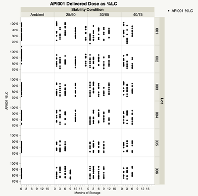

In the second case, I am just trying to size the "Ambient" category so that there isn't so much dead space before the next category (25/60) begins. In this data set, "Ambient" can only occur at t=0, so there is no reason for the other months (x-axis) to appear.

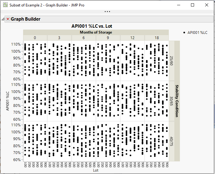

    5. Now you can run the Graph Builder Platform and create the graph you wantambient.PNG
    6. Below is a script that creates an Example data table, and then using JSL walks through the steps as defined above, and creates the new subset data table

Jim
