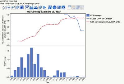

I have a similar question (?) about overlaying line graphs on top of a bar chart.  I can create them separately in different panels of a graph builder window, but don't know how to overlay them and create a Y-axis scaled to the line graphs.

If the scales are similar you can drag both y variables to the Y axis.  Then click on the line chart, and shift click on the bar chart.  After that select the variables to plot for the line and bar sections.  If the scales are different you could use a second Y axis.

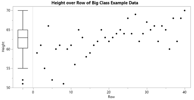

Hi @careyph,
Is this what you were looking for?

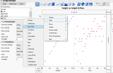

Below is a script to create this in graph builder, admittedly setting it up interactively is a little tricky.  I started with two scatterplots and added a box plot to the left one. Note that the left graph shows the same column (height) on both the x and y axis:

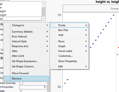

Then I removed the points from the left graph:

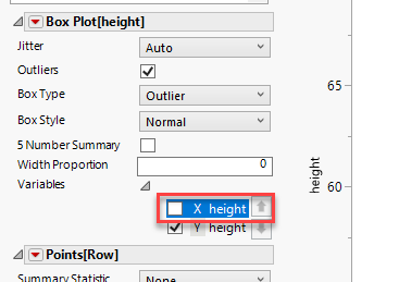

And then remove the x axis from the box plot:
Then it was just a matter of resizing the two graphs to get the chart above.
This should recreate the example chart:
