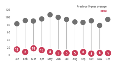

Create this type of graph
I have been asked to make a graph like the one below, comparing one year to another. But I have no idea how to do this in JMP (or anything else honestly). Can anyone help point me in the right direction?

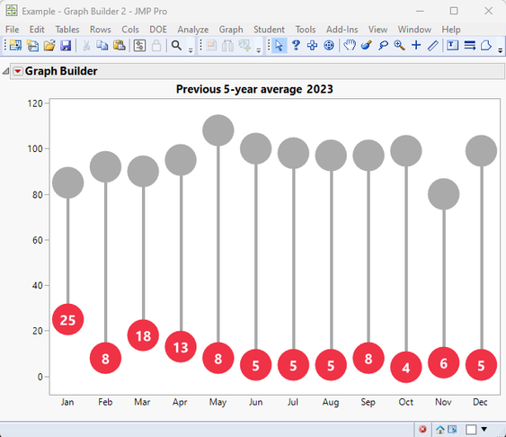

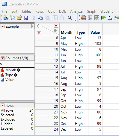

Here is one way to accomplish this.  Given a data table
I produced the below chart, using Graph Builder, with Added graphics
Below is the JSL that produced the above graph

Jim

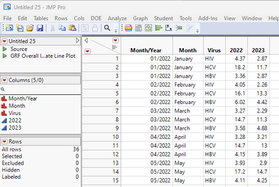

Re: Create this type of graph
Here is the data file I am using. I really want to compare it month by (one for each virus) for 2022 and 2023.

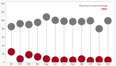

Here is another way that gets you pretty close and does not require any scripting.
One way to get this style of graph is to re-shape your data table by splitting the data into two columns, then use those columns in the Interval Dropzone. I learned this trick from @scwise from one of his Pictures from the Gallery series. Everything else is changing colors, adding annotation boxes, and hiding various chart elements.
https://community.jmp.com/t5/Discovery-Summit-Europe-2022/Pictures-from-the-Gallery-7-Select-Advance...
Hope this helps!
