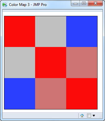

Thanks, Mark, for the suggestion.  I knew I could do it if I made the matrix into a stacked table and used graph builder or cell plot.  I was just hoping that I could use the Cell Plot Box() display object, but I think that display element is only available to internal JMP functions, not through JSL.  At least the Matrix Box() display element can be used via JSL.
I did come up with a work around, just using a graph box, that at least gets the color map (without axes labels).  See below.
// start matrix color map script
names default to here(1);
corr_mat = [1 0 -1,
                0 1 .5,
                -1 .5 1];
_nw = New Window("Color Map",
     _gb=graph box(
           SuppressAxes,
           xscale(0,1),
           yscale(0,1),
           frame size(300,300),
           nr=nrows(corr_mat);
           nc=ncols(corr_mat);
           xinc=1/nc; yinc=1/nr;
           for(ii=1, ii<=nr, ii++,
                for(jj=1, jj<=nc, jj++,
                     fill color(heat color((corr_mat[ii,jj]+1)/2, <<"Blue to Gray to Red"));
                     Rect((jj-1)*xinc,
                           1-(ii-1)*yinc,
                           jj*xinc,
                           1-(ii*yinc),
                           1
which gives this result for the 3x3 matrix

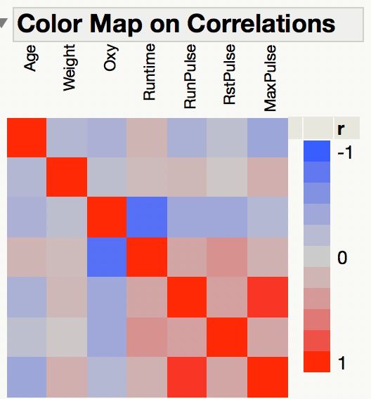

Why not use the color map of correlations in the Multivariate report?
We generally recommend using the built-in objects (entire platforms or specific display boxes in the report) as much as possible, rather than creating such objects from scratch.
It is easy to include such objects in your custom window. Just include data table reference << Multivariate( ... ) if you want the object to be 'live,' that is, respond with the usual interactivity or create the platform separately, clone the desired object, close the platform, and include or append the cloned object if interactivity is not required. (Note that you can deleted undesirable objects from the platform if you want to simplify the report for your purpose.)

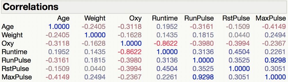

I understand now that you have the correlations in a matrix, not in a platform. The following approach might work. If so, then it can be added to your script.
I used the Fitness data table from the JMP Sample Data folder. I selected Analyze > Multivariate Methods > Multivariate. I entered Oxy through MaxPulse in the Y role. Here is the result:
You want to make this map with your matrix of correlations.
  1. Right-click on this table and select Make Into Data Table. (Note that you would first save your matrix as a data table, add the corresponding Row column, and name the data columns appropriately.)
  2. Select Tables > Stack.
  3. Select Age through MaxPulse and click Stack.
  4. Enter Correlation for the data column name.
  5. Enter Column for the label column name.
  6. Click OK.
  7. Select Graph > Graph Builder.
  8. Drag Row to X.
  9. Drag Column to Y.
  10. Drag Correlation to Color.
  11. Click the Heat Map element at the top.
Here is the result:
So I think that you can use a few high level JMP objects to obtain the heat map that you want.
I don't think it would be possible to script the heat map from scratch given its structure in Multivariate platform but others might know a way. Here is the portion of the display tree for the correlations map shown above:
txnelson
Re: Create my own color map on correlation and correlation matrix
You can do the same thing in Graph Builder, using a Shape Map.  You can create a Shape map of 50x50 or larger, and then use it with any correlation matrix up to that dimention.  The map will only display the elements it has data for, so you will only see the actual XxX matrix
