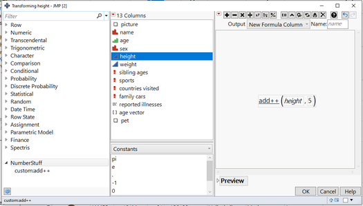

hogi
Level XIII
Re: Create/ add new columns using veribles
A combination of the previous approaches - with a little twist:
  • create a custom function *)
  • add it to a formula category
  • right click on a column header and click new formula column / hogi_0-1735893323385.png
  • use the new formula
  • ... and enter the parameter manually:
Add Custom Functions(
	New Custom Function(
		"custom",
		"add++",
		Function( {column, num_to_add},
			{Default Local},
			column,
			num_to_add
		<<Formula Category( "NumberStuff" )
The benefit: the user can enter specific parameters for every new column.
The disadvantage: no batch mode like in the previous posts.
kind of disadvantage: JMP doesn't resolve/replace the formula, it keeps it as add++(...).
   To keep it alive the formula definition has to be executed again after a restart of JMP - and maybe:  shared with colleagues.

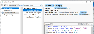

hogi
Level XIII
If you want to use exactly the same formula again and again via the new formula right click menu, you can create your own "custom function" and enable the Transform Category option to make it show up in the menu.
After a restart the code has to be executed again, so include it in an AddIn or in your startup scripts.
Names Default To Here( 1 );
myAdd =
	"custom",
	"Add",
	Function( {x, y = 1},
		x + y - 1
myAdd << Transform Category( 1 );
from scripting Index:
But this approach is very "static". To get the possibility to change a parameter, you have to vote here:
New Formula Column menu: user-Defined mini GUIs
