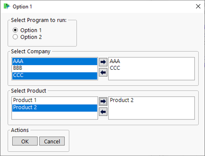

Re: Create UI to help build sql queries
This approach is a bit simpler from a UI point of view.  Functions are useful but for this example I don't think you need them.  Here's the dialog box:
Note that the selection of which program to run is now a radio box.  So instead of choosing options for program 1 and options for program 2 it serves a more singular purpose.
Here's the code:
program_list = {"Option 1", "Option 2"};
company_list = {"AAA", "BBB", "CCC"};
product_list = {"Product 1", "Product 2"};
nw = new window("Option 1", << modal,
	panel box("Select Program to run:",
		program_rb = radio box(program_list),
	panel box("Select Company",
		hlistbox(
			comp_lb = list box(company_list),
			vlistbox(
				comp_right_bb = button box("", << set icon("Next"),
					<< set function(
						function({this},
							comp_selected_lb << append(comp_lb << get selected);
				comp_left_bb  = button box("", << set icon("Prev"),
					<< set function(
						function({this},
							comp_selected_lb << remove selected;
			comp_selected_lb = list box({}),
	panel box("Select Product",
		hlistbox(
			prod_lb = list box(product_list),
			vlistbox(
				prod_right_bb = button box("", << set icon("Next"),
					<< set function(
						function({this},
							prod_selected_lb << append(prod_lb << get selected);
				prod_left_bb  = button box("", << set icon("Prev"),
					<< set function(
						function({this},
							prod_selected_lb << remove selected;
			prod_selected_lb = list box({}),
	panel box("Actions",
		hlistbox(
			button box("OK",
				continue_flag = 1;
				selected_company_list = comp_selected_lb << get items;
				selected_product_list = prod_selected_lb << get items;
			button box("Cancel", continue_flag = 0),
if (continue_flag,
//	print(selected_company_list);
//	print(selected_product_list);
	company_sql = "";
	for (i = 1, i <= nitems(selected_company_list), i++,
		one_company = selected_company_list[i];
		if (i == 1,
			company_sql = evalinsert(" AND (COMPANY LIKE '%^one_company^%'");
		// else
			company_sql = company_sql || evalinsert(" OR COMPANY LIKE '%^one_company^%'");
	company_sql = company_sql || ")";

pmroz
Here's the code:

Tom_P
Level III
@pmroz
I really appreciate the help and very much like your idea as well
When i run the script as-is, the embedded log does not pick up on my selections and instead shows emptiness even though i made selections
"Select *
   from TABLE.DATA
  WHERE SCANDATETIME > (SYSDATE - 30)
How can this be remedied?
Tom_P
Level III
@pmroz
My apologies
This worked perfectly and i clicked on the selections but did not move them to the right sections to "choose" their value.
Sorry for the mixed message.
Another great solution!
