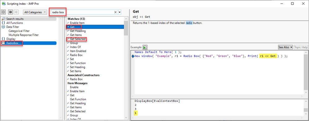

Re: Setting up a pre-selection of categories and variables for Dashboard users
You could use rb << Get or rb << Get Selected.  Here is how I found that in the scripting index (available under the help menu):
